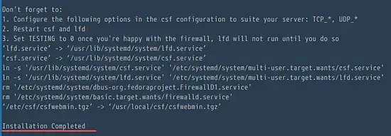

Extract the tar.gz file and go to the csf directory, then install it:
tar -xzf csf.tgz
cd csfsh install.sh
You should get the information that CSF installation is completed at the end.
CSF installation is complete.

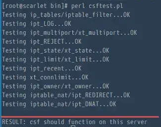

Now you should check that CSG really works on this server. Go to the “/usr/local/csf/bin/” directory, and run “csftest.pl” .
cd /usr/local/csf/bin/perl csftest.pl
If you see the test results as shown below, then CSF is running without problems on your server:
RESULT: csf should function on this server
CSF is running.
