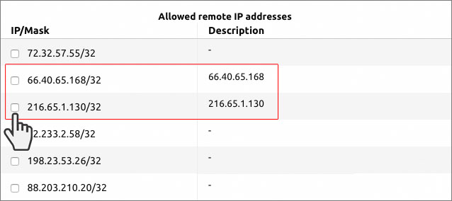

Outgoing Connections

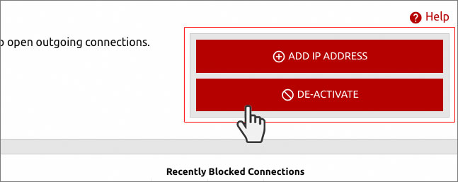

Remote content can’t always be trusted. On our web hosting platform, we have disabled outgoing connections by default.
Only connections to globally whitelisted IPs are allowed. This way your sites and applications will be protected from unsolicited connections to external hosts.
You can rest assured that no one can break into your code and send data to a particular host of their own for illegal purposes.
Of course, you will be able to authorize connections to a specific host or network mask via the Hepsia Control Panel integrated ‘Outgoing Connections’ section, or allow all outgoing connections.

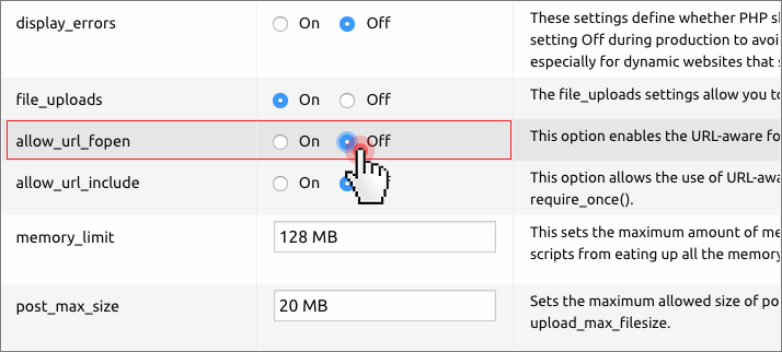

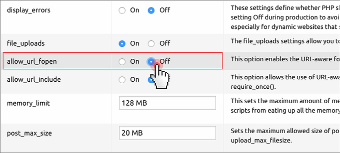

If you do the latter, you may still want to limit the ability of fopen wrappers to open remote URLs.
Using the Hepsia Control Panel, you can disable URL-aware fopen wrappers with a click from the php.ini file area of the PHP configuration section:
If you want to edit the php.ini directly, check the following lines:
allow_url_fopen = 0 allow_url_include = 0
And make sure they are both set to “0”. This will set fopen wrappers to only be able to load local content.

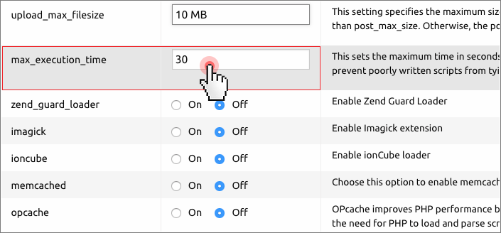

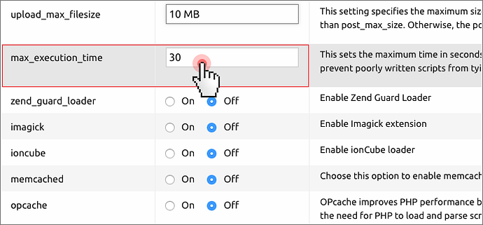

You should limit the maximum amount of time that a PHP script can run before it is terminated by the parser, as well as the amount of time allowed to process inputs. In the example below, this limit is set to 50 seconds.
As a result, a compromised script won’t run or read inputs for a large period of time.
max_input_time = 50 max_execution_time = 50
This is how the runtime settings can be managed on our platform:

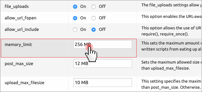

In the php.ini file, you can set the maximum amount of memory that a script is allowed to allocate.
memory_limit = 8 M
Never allow a PHP script to use more than 8 MB of memory.
This will help prevent poorly written scripts from eating up all the memory available on the server.
In the Hepsia Control Panel, you can set the maximum amount of memory with a click of the mouse:

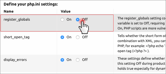

Disabling the “ register_globals ” setting will help you stop request data from being stored as a variable.
This is necessary since environment variables can easily be modified.
register_globals = off
Note: This setting is only applicable to older versions of PHP such as PHP 4, PHP 5 and PHP 5.3

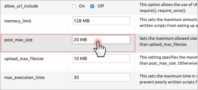

By limiting the size of post data and request data, you’ll be able to curb the effects of a potential hacker attack, which tries to flood web application resources.
post_max_size = 256 K max_input_vars = 100
Provided your application has file upload capabilities, make sure that “ post_max_size ” has a set value at least as big as “ upload_max_filesize “:

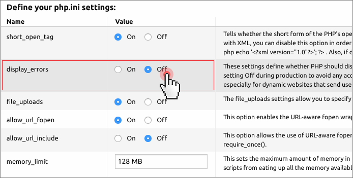

Error Logging
Error messages should be logged to a secure file on the server.
They are not to be displayed to the end user since the information they contain can potentially point hackers to the vulnerabilities of your code.
display_errors = 0
From the Hepsia Control Panel, you can easily turn this setting Off during production so as to avoid any accidental display of sensitive information about your website.
This is especially useful for dynamic websites that send usernames and passwords to access a database.
By logging PHP errors, you can both efficiently find vulnerabilities and debug the application code.

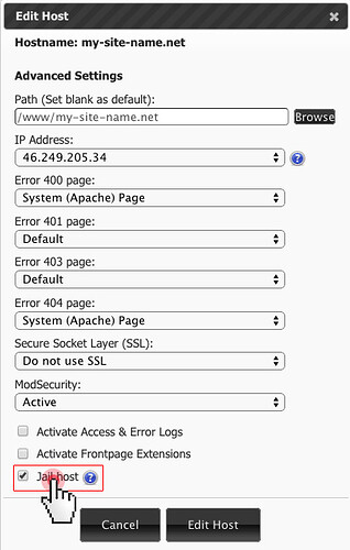

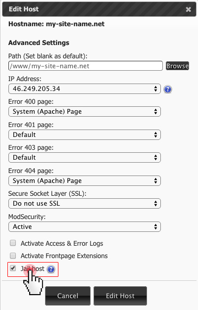

On our platform, you can make use of the ‘Jail host’ option, which helps address a very specific security problem.
The ‘Jail Host’ option allows you to isolate a given host from the other domains within the www/ directory of a hosting account.
This way, if hackers try to attack the given host, they will be immediately ‘jailed’ in that host, i.e. they will not be able to use the host as a doorway to the rest of the system where the other hosts of yours are located.
The “jail host” restriction works at the Operating System level, which will guarantee its efficiency in all cases of hack attacks on the given host.

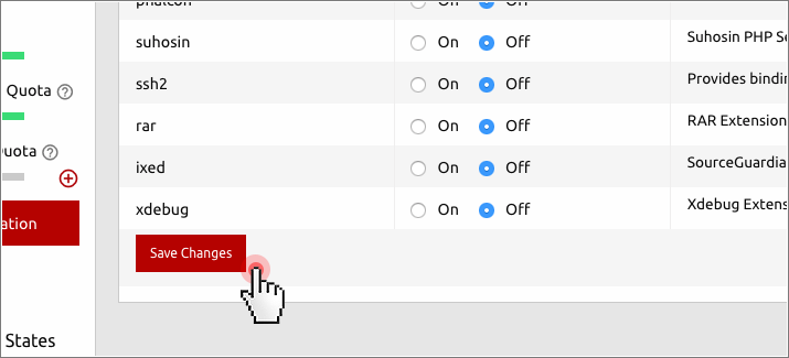

On our web hosting platform, you are free to update the php.ini file with a click on the Save settings file in the Control Panel.
All changes will be reflected on the web server without you needing to restart anything at your end.
