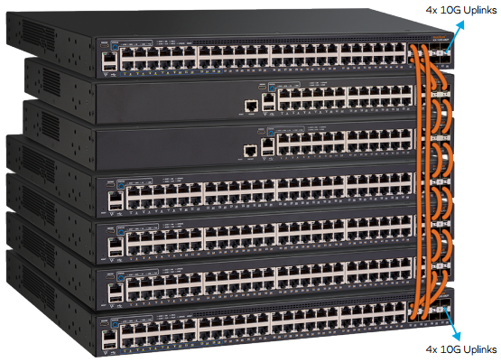

Ruckus stacking technology2 makes it possible to stack up to twelve Ruckus ICX 7150 switches into a single logical switch. This allows the Ruckus ICX 7150 to deliver a class-leading 480 Gbps of aggregated stacking bandwidth and offer simple and robust expandability for future growth. Stacking is supported across the ICX 7150 family and all ICX 7150 models including the ICX 7150 compact switch and the ICX 7150-48ZP can be mixed within the same stack. This stacked switch has only a single IP address that simplifies management and offers transparent forwarding across up to 600×1 GbE ports or up to 192×2.5 GbE ports, and up to 96×10 GbE ports. When new switches join the stack, they automatically inherit the stack’s existing configuration file, enabling a plug-and-play network expansion.
Because the ICX 7150-48ZP switch has twice as many uplink ports, when it is added to a stack of other ICX 7150 switch models, the effective bandwidth of all the switches is doubled. By designing the stack this way, all four of the 10GbE ports on the ICX 7150 switches can be used for stacking (rather than having to split the four ports between stacking and uplinks), and leveraging four of the 10GbE ports on the ICX 7150-48ZP for stacking and the other four 10GbE ports can be used for uplinks.
