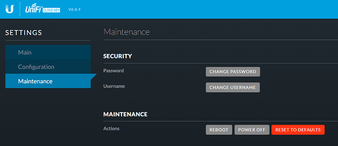

1. Reboot
As a first step, some Cloud Key issues can be resolved with a simple reboot. If you have not done this, do so now. This can be done by following these steps:
  1. Open the Cloud Key management portal in a browser by typing the IP address of the Cloud Key as URL: i.e. https://192.168.1.15
  2. You may receive a Privacy Error. Click continue.
  1. Click Configure
  2. Log in with UniFi Cloud Key credentials used at setup. See our Related Articles below for credential questions.
  3. Select the Maintenance tab.
  4. Under Maintenance > Actions , click the button to Reboot .
If this does not resolve the issue, then proceed to the next paragraph.

Reset Method 1: WebUI
  1. Open the Cloud Key management portal in the browser by typing the IP address of the Cloud Key as a URL: i.e. https://192.168.1.15.
  2. You may receive a Privacy Error, in Chrome, click Advanced > Proceed to IP of Cloud Key .
  3. Click Configure .
  4. Log in with UniFi Cloud Key credentials used at setup. See our Related Articles below for credential questions.
  5. Select the Maintenance tab.
  6. Click Reset to Defaults .

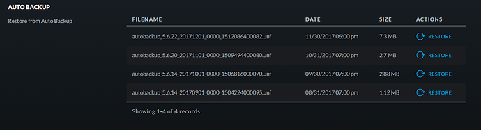

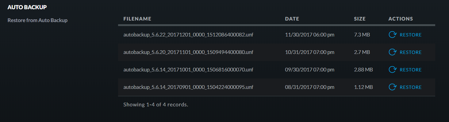

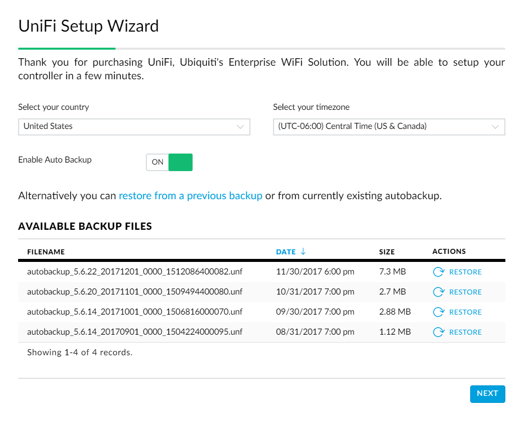

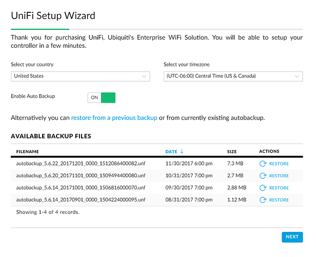

How to Restore from Last Working Backup
Once your reset has completed successfully your Cloud Key should be in a factory default state- which will eliminate any database corruption/corrupted configuration of the Cloud Key. Now you are ready to restore from your last known working backup. Here are directions on how to do this:
Restore Method 1: Via UniFi Setup Wizard
  3. Select Manage .
  4. The UniFi Setup Wizard will present existing Auto Backup files stored on the SD card.
  5. Select which backup to restore and click Restore .

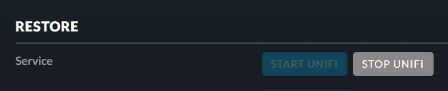

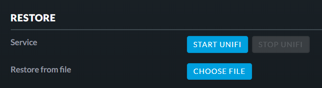

Restore Method 2: Via WebUI
  4. Login with default UniFi credentials:
  • Username: ubnt
  • Password: ubnt
  1. Go to the Maintenance tab.
  2. Click the Stop UniFi button, once the Start UniFi button becomes highlighted (appears clickable), proceed to the next step. restoreck.png
  3. Under Auto Backup select the most recent working backup file and click Restore .

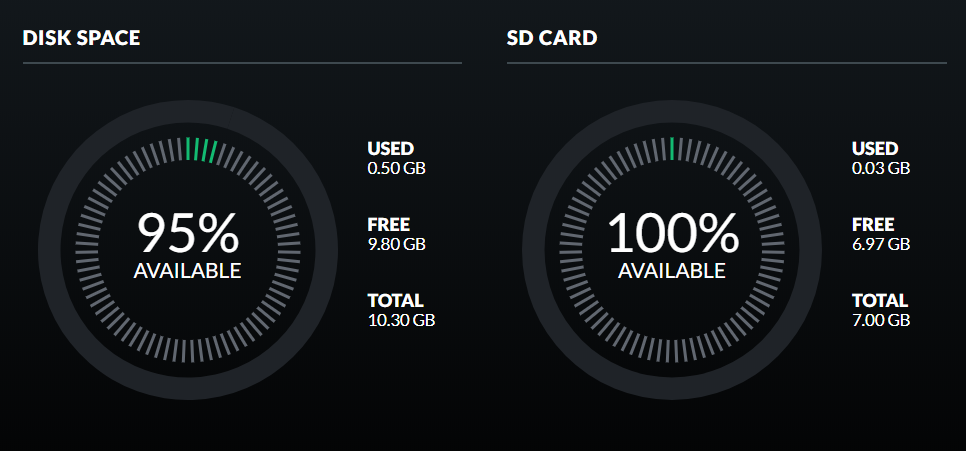

Cause 2: Disk Space
The Cloud Key was built for compact form, ease of install and affordability. With this comes less disk storage than you’d find on a server that would otherwise be running the UniFi Controller substance. In most environments, this will not become an issue and requires little consideration. However, in larger environments or configurations that have opted to retain more detailed data and a larger number of backups, disk space can become an issue. For this reason, it is good to monitor the disk usage on the Cloud Key regularly just to ensure that the disk space isn’t over-utilized.
https://help.ubnt.com/hc/en-us/articles/360000128688-UniFi-Troubleshooting-Offline-Cloud-Key-and-Other-Stability-Issues#3.2
Symptoms
  • Storage Space Shows as close to 100% utilized
  • Cloud Key will shut down the controller service without warning as disk space is exhausted/MongoDB is unable to write to the database further
How to Prevent
  • Periodically check the Cloud Key disk utilization through the WebUI > Configure > Main.
  • Limit the number of backups stored on the Cloud Key. If longer retention of backups/data is needed, download these files then remove from Cloud Key storage.
  • Decrease the length of data retention in the UniFi Controller under Settings > Maintenance > Data Retention.
  • If you frequently exhaust disk space, add a larger microSD card to your Cloud Key.
  • Perform regular compacts on Database under Settings > Maintenance > Compact Database .
  • Remove excessive backups under Settings > Auto Backup

  • Verify the size of your backups is not approaching the 2GB limit under Settings > Auto Backup .
  • Reduce Data Retention Settings, then Compact Database under Settings > Maintenance > Compact Database .
